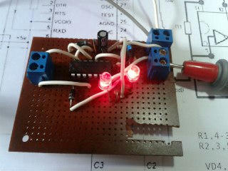

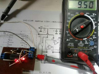

hamed-pc 13.06.2016 14:59
Сообщение от ayra66 (Сообщение 359331)
hamed-pc Here is schematic for you
Hi Dear ayra66
How are you my friend ?
i Build this schematic . send me From you
https://www.mediafire.com/convkey/1b....jpg?size_id=3
http://www.mediafire.com/convkey/c5e...9wucla6fzg.jpg
But i have question Before connect my car
1: LED VD4,5 When On . When OFF ( for me always on )
2: on the output from BC547 ( K line) what volt When not connect to k line Care
Can you send me Picture of you'r Board ? when working ? or turn on power ?
Thank you And Best regards
ayra66 13.06.2016 17:01
hamed-pc Thank you,I am fine.
The VD4 is on allways when you connect the adaptor to your car ciadnostic harness(the adapter is resiving +12volt from your car).
VD5 will blink when you send or resive signals from car.
On the collector of the transistor will be nearlly 12volt when the k kine wire is disconnected but the power and ground are connected .
The video of my adapter work I will sent to Your Personal mesiges in this site later.
