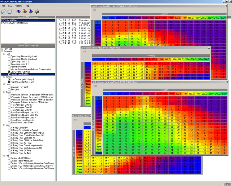

EcuFlash - утилита для считывания/записи/редактирования данных ROM ECU, т.н. карт или таблиц. C ней в комплекте идут и драйверы под мой кабель. Картинка

-Plug the cable into the car, turn the car to on (but not starting it), and open ecuflash. The "Read from ECU" icon should go blue, indicating that the drivers work and it is connected.
-Close ecuflash and run the installer for ecuexplorer. Run ecuexplorer. You should show up as connected and talking to com port 6. Try the realtime data viewer and verify that it works.
-Close ecuexplorer and install enginuity. Run enginuity. You should also show up as connected and talking to com port 6. You might have to select that, though. Com port 5 shows up as the default on mine. Try the logger and verify that it works.
