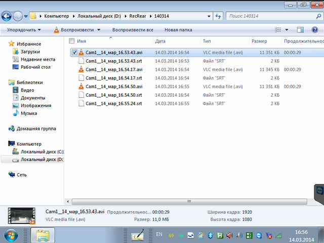

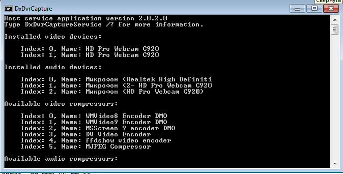

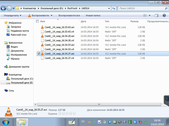

Купил вторую камеру С920. Подключил, настроил конфиг...Начались глюки. Одна камера пишет нормально. Вторая - файлы по 128kb. Причём передняя камера пишет в папку "RecRear".

Log:
Код:
5064 2014-03-14 16:53:43,402 [5064] INFO  Logger                                        [dingSizeNotReached] - Searching files for cleanup...
5064 2014-03-14 16:53:43,512 [5064] INFO  Logger                                        [dingSizeNotReached] - Finishing searching.
5064 2014-03-14 16:53:43,592 [5064] INFO  Logger                                        [RunRecordWork     ] - New CapturingProcessor initialized.
5064 2014-03-14 16:53:43,592 [5064] INFO  Logger                                        [RunRecordWork     ] - Recording started.
4476 2014-03-14 16:53:46,547 [4476] INFO  Logger                                        [StartRecord       ] - INIT!
4476 2014-03-14 16:53:46,547 [4476] INFO  Logger                                        [StartRecord       ] - 11429296
5064 2014-03-14 16:53:49,793 [5064] INFO  Logger                                        [StartRecord       ] - INIT!
5064 2014-03-14 16:53:49,793 [5064] INFO  Logger                                        [StartRecord       ] - 11429296
5064 2014-03-14 16:54:20,105 [5064] INFO  Logger                                        [RunRecordWork     ] - Recording finished.
5064 2014-03-14 16:54:20,109 [5064] INFO  Logger                                        [dingSizeNotReached] - Searching files for cleanup...
5064 2014-03-14 16:54:20,109 [5064] INFO  Logger                                        [dingSizeNotReached] - Finishing searching.
5064 2014-03-14 16:54:20,134 [5064] INFO  Logger                                        [RunRecordWork     ] - New CapturingProcessor initialized.
5064 2014-03-14 16:54:20,139 [5064] INFO  Logger                                        [RunRecordWork     ] - Recording started.
4476 2014-03-14 16:54:20,254 [4476] INFO  Logger                                        [StartRecord       ] - INIT!
4476 2014-03-14 16:54:20,254 [4476] INFO  Logger                                        [StartRecord       ] - 11429296
5064 2014-03-14 16:54:23,269 [5064] INFO  Logger                                        [StartRecord       ] - INIT!
5064 2014-03-14 16:54:23,269 [5064] INFO  Logger                                        [StartRecord       ] - 11429296
5064 2014-03-14 16:54:53,536 [5064] INFO  Logger                                        [RunRecordWork     ] - Recording finished.
5064 2014-03-14 16:54:53,540 [5064] INFO  Logger                                        [dingSizeNotReached] - Searching files for cleanup...
5064 2014-03-14 16:54:53,540 [5064] INFO  Logger                                        [dingSizeNotReached] - Finishing searching.
5064 2014-03-14 16:54:53,575 [5064] INFO  Logger                                        [RunRecordWork     ] - New CapturingProcessor initialized.
5064 2014-03-14 16:54:53,575 [5064] INFO  Logger                                        [RunRecordWork     ] - Recording started.
4476 2014-03-14 16:54:53,755 [4476] INFO  Logger                                        [StartRecord       ] - INIT!
4476 2014-03-14 16:54:53,755 [4476] INFO  Logger                                        [StartRecord       ] - 11429296
5064 2014-03-14 16:54:56,765 [5064] INFO  Logger                                        [StartRecord       ] - INIT!
5064 2014-03-14 16:54:56,765 [5064] INFO  Logger                                        [StartRecord       ] - 11429296
5064 2014-03-14 16:55:27,033 [5064] INFO  Logger                                        [RunRecordWork     ] - Recording finished.
5064 2014-03-14 16:55:27,037 [5064] INFO  Logger                                        [dingSizeNotReached] - Searching files for cleanup...
5064 2014-03-14 16:55:27,037 [5064] INFO  Logger                                        [dingSizeNotReached] - Finishing searching.
5064 2014-03-14 16:55:27,067 [5064] INFO  Logger                                        [RunRecordWork     ] - New CapturingProcessor initialized.
5064 2014-03-14 16:55:27,067 [5064] INFO  Logger                                        [RunRecordWork     ] - Recording started.
4476 2014-03-14 16:55:27,257 [4476] INFO  Logger                                        [StartRecord       ] - INIT!
4476 2014-03-14 16:55:27,257 [4476] INFO  Logger                                        [StartRecord       ] - 11429296
5064 2014-03-14 16:55:30,267 [5064] INFO  Logger                                        [StartRecord       ] - INIT!
5064 2014-03-14 16:55:30,267 [5064] INFO  Logger                                        [StartRecord       ] - 11429296
