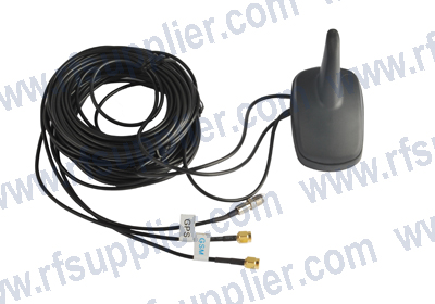

Заказал антенку GPS+WiFi+GSM. Придет, пощупаем, что за зверь.
GPS,GSM,WIFI funtions 3 in 1.
(i)Dieletric Antenna
Center Frequency 1575.42MHz±3 MHz
V.S.W.R 1.5:1
Band Width ±5 MHz
Impendence 50 ohm
Peak Gain >3dBic Based on 7×7cm ground plane
Gain Coverage >-4dBic at –90°<0<+90°(over 75% Volume)
Polarization RHCP
(ii)GSM Antenna
Center Frequency 824MHz~894MHz;880MHz~960MHz;
1710MHz~1990MHz
V.S.W.R 2.0:1
Impendence 50 ohm
Typical Gain 2dBi+/-1dB@850MHZ;
2dBi+/-1dB@900MHZ;
1dBi+/-1dB@1800MHZ; 1dBi+/-1dB@1900MHZ
(iii)Wifi Antenna
Frequency Range 2400-2500 MHz
VSWR ≤1.5
Gain 2.15dBi
Impedance 50 ohm
Polarization Type Vertical
(iv)LNA/Filter
LNA Gain(Without cable) 28dB Typical
Noise Figure 1.5dB
Filter Out Band Attenuation (f0=1575.42 MHZ)
7dB Min f0+/-20MHZ ;
20dB Min f0+/-50MHZ;
30dB Min f0+/-100MHZ
V.S.W.R <2.0
DC Voltage 2.7V/3.0V/3.3V/5.0V/3.0V to 5.0V/other
DC Current 11mA Max
(v)Mechanical
Weight <240gram
Size 70mmx70mmx14mm
Cable
GPS-----RG174 3meter,2meter, 5meter long
GSM-----RG174 3meter,2meter, 5meter long r
Wifi-----RG174 3meter,2meter, 5meter long
Connector
GPS-----Connector :SMA/SMB/SMC/BNC/FME/TNC/MCX /MMCX /Fakra/AVIC/WICLIC in straight or right angle please give us some notes if the antenna connector is chosen.Tks!
GSM-----SMA/SMA/SMB/SMC/BNC//TNC/MCX/MMCX or other
Wifi-----FME /SMB/SMC/BNC/FME/TNC/MCX/MMCX or other
Mounting Screw Mounting
Housing Black
(vi) Environmental
Working Temp. -40℃~+85℃
Storage Temp. -45℃~+100℃
Vibration Sine sweep 1g(0-p)10~50~10Hz each axis
Humidity Humidity95%~100%RH
Weatherproof 100%Waterproof

Wi-Fi у антенны не лучше штатной, разве что вынесена на улицу. GPS и GSM пока не подключил.
